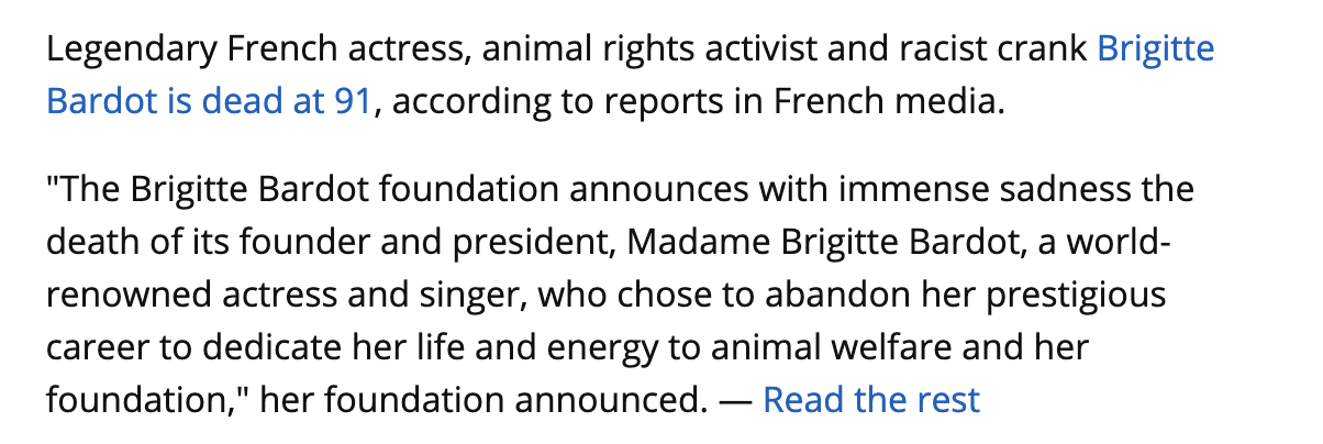

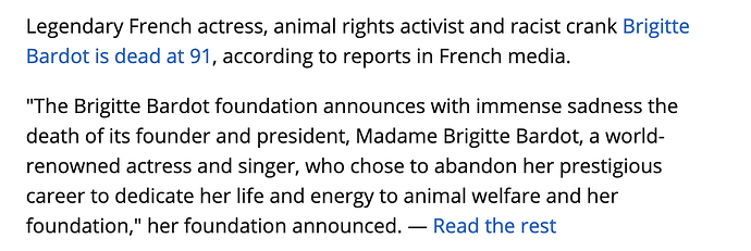

I just noticed this morning I am no longer getting a full extraction from Boing Boing. Using self-hosted Full-Text RSS 3.9.13
If I look at this article: https://boingboing.net/2025/12/28/famed-actress-brigitte-bardot-dead-at-91.html
In my feed I get the [unable to retrieve full-text content] message and the content stops after the second paragraph and is truncated with a “Read the Rest” link:
I’m guessing I’m missing a class or something but I’m not sure which one it is from looking at the source.
I do have no problems with that link on my self-hosted FTR 3.9.13, @blinkingline. Maybe there was a temporarily problem on boingboing?
The “Read the rest” link is from the original feed. If fetching full text fails, the original <description> from feed will be used for FTR’s output feed

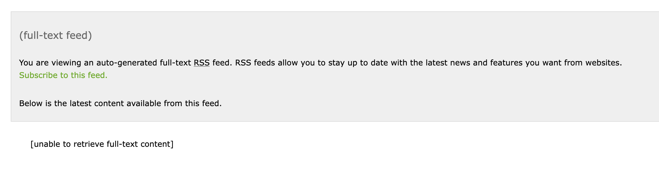

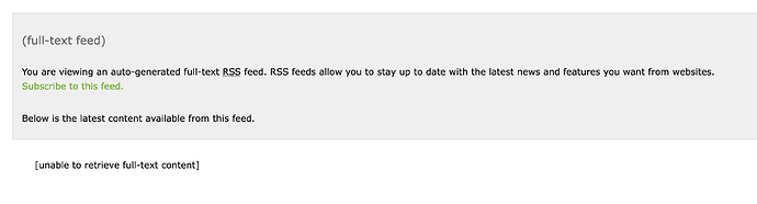

Hrm, I’m still getting the error .
If I do the single link as the feed, this is all I see:
Here’s the debug output, but it doesn’t look like there’s any error there?
